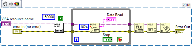

A very common error when reading Serial Data is to use "Bytes at Port" to control the VISA reads, which can result in strange happenings.  I notice you have set the "Use Termination Character" input, which means you expect your Instrument to send you a complete string.  Well, that's what you want to do!  Here's my re-write of of your code (with details omitted):VISA InputVISA Input.
Some obvious points (which are not entirely trivial):
  • Error Line and VISA Line "run through it" and are kept straight.  Error Out is named "Error Out".
  • Configure Serial Port inputs that are Defaults (except for critical Enable Termination Character) are left blank.  I notice you have an unusually large Timeout (2.5 minutes!).
  • VISA Buffer Size not used -- default Buffer of 4096 should not put a strain on your memory resources!
  • Key step in inside the Loop.  Do a VISA Read of more characters than you ever expect in a string.  This returns you an "entire" VISA Read (or else a TimeOut if the Instrument stops for some reason).  So when the VISA Read returns, you have an entire String to parse, and hence are much less likely to make parsing errors.
  • Note that there are no Timing modules inside the loop -- the Loop is being clocked by your Instrument, looping once per data "chunk" (I'm assuming the data comes in slower than the LabVIEW code to process it -- if you have too much processing code inside the loop, use a Producer/Consumer Design to move the processing to a Consumer Loop).
If you run this code with your Instrument, you can bring Data Read out through an Indexing Tunnel and get an Array of Strings showing just what your Instrument is sending you.  If you are having parsing difficulties, sending us a sample of these data would help us suggest what might be going astray in your parse.
