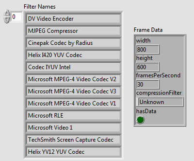

Use IMAQ AVI Get Filter Names.vi to read out the installed compression filters at your system.
I have the following filters installed, whereas your AVI worked well:
Christian
Message 4 of 9
(4,680 Views)
    I'm sure it's not a problem with missing or incorrect compressors, because the files plays normally in any media player. The problem arises when loading the movie file in LabVIEW. Proof that this in not the problem is that it actually loads a few frames (about a dozen) before the error.
    One odd thing I found is that IMAQ AVI GET INFO does not recognize the compressor (it uses Microsoft MPEG4 V2) in the AVI file, but finds it correctly with IMAQ AVI GET FILTER NAMES.
