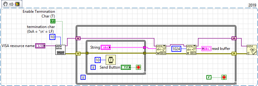

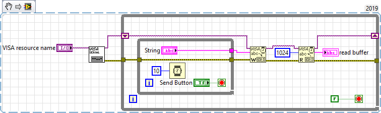

  1. Open one VISA session at the beginning of your program
  2. Use that same VISA session for every VISA Read or Write in your program by using a shift register to pass that VISA session around your program's main loop
  3.  Close the VISA session at the end of your program
DO NOT open a VISA session for one read or write close it and open a new one every single time!
Here's a very simple example...

So if i want to make visa write and visa read work at the same time, I have to use shift register in my loop ?
Yes, here's a little better example for you. Notice I have the Termination Character enabled and set to the default \n or Line Feed and I have set the VISA Read to read far more bytes than I ever expect to receive.
Now when you send a command the VISA read will read until it receives the Termination Character or times out.
This is how you do serial communications with VISA and any serial device.
In your Arduino sketch use the PrintLn command as it appends a Line Feed onto everything for you.
