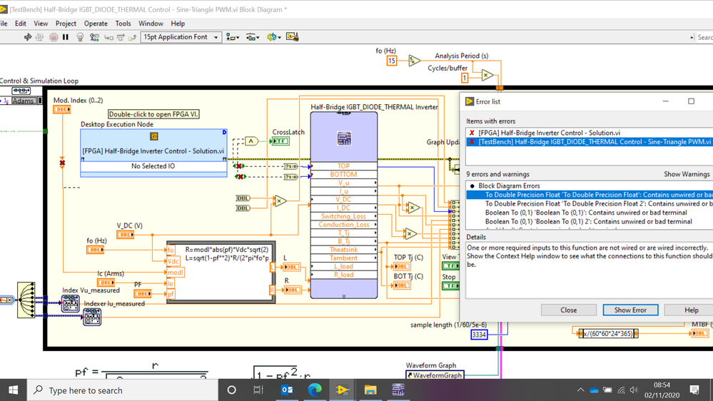

1) The first error is with the Half_Bridge_Diode_Thermal programme.

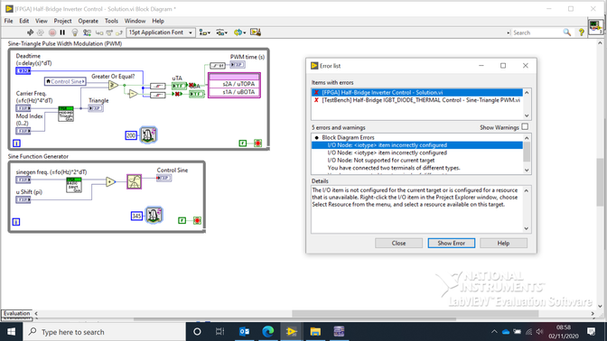

2) The second is with the FPGA Half Bridge Control programme: The error message states item configured incorrectly.

Sorry about that. It would be useful to actually see what the problem is.
This is the first problem.
This is the second problem

Picture 1: Do you have the simulation toolkit installed?
Picture 2: Do you have the LabVIEW FPGA module installed and are opening the VI under the FPGA target?
Note that you can always double-click on an error in the list and it will take you to the problem diagram location.

I don't know much about FPGA, but on the 1st picture you've simply missed/forgot to wire several inputs. The Boolean to 1:0 don't have any Boolean inputs, for example.
