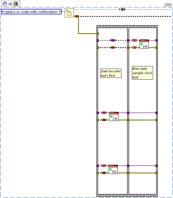

I'm just getting back to this reply and see that Jeff B and you are already having some discussion.  I partly agree but not fully.  I also have my own mistake to correct.  Here goes:
1.  The buffer overflow from my posted example might likely be due to an oversight on my part when tidying wires.  I didn't enforce sequencing to make sure tasks can't start before the file dialog has returned.  The following dataflow sequencing will do that, just branch the output error wire from the file dialog to the left side of the sequence frame:

4. One place I disagree with Jeff B is about the ability to achieve sync.  You're already [mostly] set up to get it exactly right because you've configured your encoder tasks to be "Arm-Start Triggered."   The likely problem (as I mentioned back at the end of msg 2) is that you aren't programmatically controlling when that trigger signal gets asserted.  I suspect it's a repeating signal that's already present when you run your task, causing one task to be triggered slightly before the other.
   However, now that I've corrected your sequence so the encoder tasks start before the sample clock, you should still be fine if your program starts in the absence of any encoder motion.  The Arm Start Trigger enables the counter to let the count register be updated by encoder motion.  In the absence of motion, the count register stays at 0.  The shared sample clock that starts after the encoder tasks helps keep your acquisitions in sync.
   Again, as mentioned in msg 2, if motion can be present when you start your program, *YOU* must control the generation of the Arm Start signal and it must *not* happen until after both encoder tasks have started.  I'd also wait until after starting the pulse train that's used as a sample clock.
5.  Jeff has a lot of insights packed into msg 8, but I'm pretty sure you aren't in the kind of situation that needs them.  From some of the comments, I suspect he might not know about Arm Start Triggers for counters.  Jeff?
6. Note that for the data you *did* get, the lag has dropped to just under 1 millisec.  I strongly suspect this improvement came from me de-serializing the encoder task starts (similar to Jeff's advice about de-serializing the reads), making them very much more nearly simultaneous.  Now, you just have to take control over the Arm Start Trigger signal so that they *have* to start *exactly* simultaneously.
   I would guess from your latest data set that motion must have been present at the time you started the program, otherwise I would have expected the data to be perfectly in sync already for all the reasons already stated.
