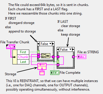

There's something fishy about this code:
The purpose is simple: because of other limitations, to send a large file (string) over a TCP connection, I have to "chunk" it up and send it in pieces.
Each block has a FIRST and a LAST flag, and a chunk of string.
The point of this code is to assemble those chunks back into a single string on the receiving end.
I use the same VI both in the HOST (windows PC) and on an RT target (PharLap)
The code works fine.

Why is that ?  it is as if there is something different about the VI when compiled for Host, or when compiled for RT.
By itself, that is nothing more than a nuisance.
BUT
Now I have compiled it into a PPL (*.lvlibp).  I compiled it on the RT side, but when I use it on the Host side, it complains that the VI is broken, because it's "missing a connection to an external routine".
It's not smart enough to tell me WHAT it's missing, but that's the message.
If I open the PPL solo (without a project), that VI is just fine.  But when it's used on the host side, it's broken.
That reinforces the idea that something about the VI is particular.
I have lots of other VIs that are shared (host & RT) without this problem.
This is the only one with a FEEDBACK NODE.
If I rework the VI to use a WHILE LOOP and a shift register, then the problem goes away.
What is it about FEEDBACK NODEs that is so squirrelly ?

Are you sure it is the feedback node that is causing it?  I'm thinking it is more that the same VI is being used on both targets.  Each target compiles it differently.  And whichever way it was last saved, the LV recompiles it for the other target and then asks you to save it because it is recompiled.
Suppose you made two identical, but separate VI's, one for each target.  I'm thinking that neither will be ask to be saved after the first time each gets saved.

Maybe it is something about feedback nodes that compile differently as compared to other program aspects, but the fact it is based on the targets changing I think is still the key part of the equation.  It is interesting that a shift register is not causing this while a feedback node it, because I often think those two things are interchangeable.  But they probably aren't truly identical and there maybe some slight, subtle difference about a feedback node as compared to a shift register.
Maybe someone from NI who knows more of the underpinnings of the compiler can explain why a feedback node would cause it to compile differently for different targets and will respond.

For what it is worth...
The initializer terminal is unique from the SR.
When used in FPGA it is different.
