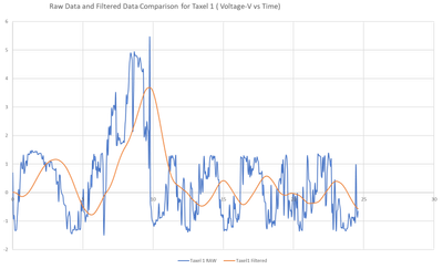

4. I used random values to filter my signals. What I found is a delay between raw data and filtered data. How to reduce this delay? (Picture attached)

You ask about reducing the delay between the "raw signal" and the "filtered output".  Why is there a delay?  Because the filter cannot "predict the future" -- it is only looking at the signal now and in the past, and does not know how the signal will change in the future.  Have you heard the terms "corner frequency" for a simple RC circuit?  How about "transfer function", which describes how the ratio of the output-to-input of a filter depends on the frequency of the signal coming into the filter?  [Ask a EE student about it, or one of your Engineering faculty].
