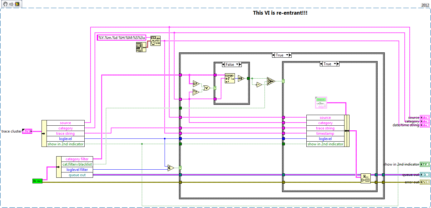

I've written a library for logging and tracing based on a queue.
Clients can call a reentrant VI by reference (called "trace.vi")  to put trace elements into the queue while a parallel background task is processing the queue.
In order to add a timestamp to each trace element I use a Get Date/Time object in my reentrant "trace.vi" before putting the trace element into the queue
But there's a problem with these timestamps.
I often get a couple of consecutive trace elements with exactly the same timestamp (resolution is milliseconds) and I'd expect to see at least a small difference.
First I thought the poor resolution of the Get Date/Time object might be the cause, but after a few sample VIs I found out this isn't true.
Any ideas what might be the problem here?

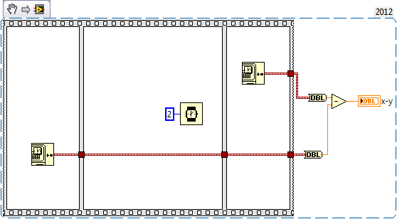

Have a look at the sample VI below, it shows that a resolution of 2msec is possible.
I'm using a reentrant VI and not an 'Action engine', because I have multiple threads in my project that should be able to trace at the same time.
Race conditions are avoided by accessing a queue in a reentrant VI.
Even I had mentioned in my previous reply that:
@moderator1983 wrote:
Resolution of any timing function is in milliseconds, when running on Windows.
But the problem that you're facing is because, there could be a possibilty when two or more clones (reentrant VI's instances) were called and the queue were updated within very short duration (within a fraction of millisecond)... Now as LabVIEW timing functions have resolution upto milliseconds and not greater than that, you'll see different traces being inserted at same time.

In VI Properties > Execution I tried both "Shared clone reentrant execution" and "Preallocated clone reentrent execution".
As I said, the reentrant execution is required because of multitasking and the VI is called by reference.
As you can see from the snippet below, I add a timestamp to a cluster containg trace information elements and put everything into a queue.
A millisecond resolution is sufficient for our purpose.
I just can't believe that traces with the same timestamp are really happening in a 1msec timeframe.
I rather think the reentrant execution is not working like expected.

Just a suggestion; rather than calling the "Get Date/Time In Seconds" function for the input to "Format Date/Time String"; leave the input to "Format Date/Time String" unwired; it will default to the current date/time.
Just a guess but maybe LabVIEW is somehow grouping the near simultaneous calls to the "Get Date/Time In Seconds" primative into a single OS call.
