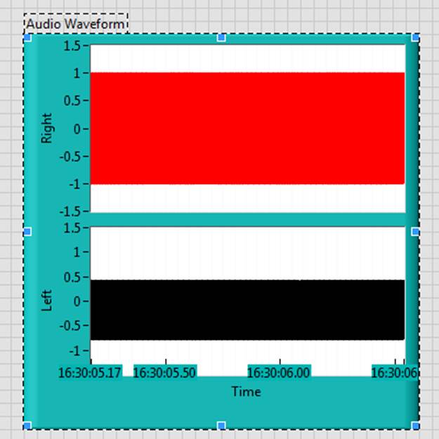

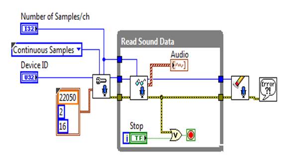

I'm using the Continuous Sound Input.vi in Labview 2014 as below (Device ID =0; Number of Samples/ch = 5000):
When I have both Left and Right channels plugged into mic input on my PC, I can read both channels with full scale (-1 to 1) which is correct. The problem I have is that when I unplug one channel,  the output from Sound Input Read.vi still shows centain level of signal for this missing channel (Left ch in this case) (see below). However, if I attentuate the mic input signals, the problem is gone -- the missing channel shows no reading from Sound Input Read.vi. Can someone tell me why the Sound Input Read.vi behaves this way? Is there any fix to this problem?

My test setup is very simple: a stereo audio cable with two RCA connectors (for left and right channels) at one end and a 3.5mm plug at the other end is connected between DUT and PC (stereo mic port 3.5mm Jack). The display shows the audio waveforms (left and right channel) from the Sound Input Read.vi. In the block diagram, it's the "Audio" indicator.
First I thought it was a problem with Labview sound input vis. But then I found actually there was very weak sound from the missing channel when I plugged in my earphone into PC (earphone port) and listened very carefully to it. The test signal is just a 1KHz tone and that's what I hear and that's what shows in the waveforms (if expanded the window). The measured frequency is also correct. So I know it's not noise related. The rough conclusion we can make here is that the audio signals from DUT are too strong for the mic circuit and sound card on the PC. The channel signals got screwed up somewhere. If you have more insights about this, please kindly share.
