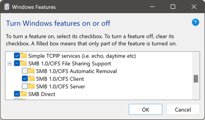

Specific to Windows 11 and SMB 1, then it is disabled by default. As already mentioned.
It is enabled by selecting the shown settings in Windows Features On/Off :
But then there is an additional issue with version 22H2 and SMB 1. Small KBytes files fails to transfer. Larger MBytes transfers fine. The easiest way to solve that issue is upgrading to 23H2. It can be quickly done by the Enablement Package KB5027397.
