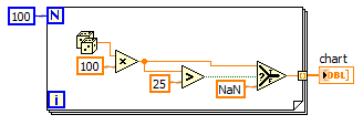

Mike,
How I can use NaN for this simple graph. Thee random numeric plot to graph. If random number 0 use NaN? (this is same case like my problem when read data from device)
http://prntscr.com/6z1n74
(4,166 Views)
Accepted by topic author Qooler
Hi Qooler,
again: PLEASE DO NOT POST LINKS TO 3RD PARTY WEBSITES! Attach images directly in this forum!
Yours: img.png(Using AutoClenaup would be nice before posting images…)
