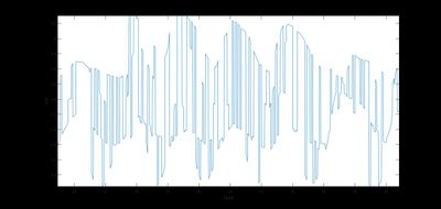

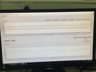

I seem to have a problem with saving the data acquired from an A/D, while the data appears continuous in the GUI , when plotting the data that was written into the cvs. file - it seemed to contain random drops in the data, that did not appear in the GUI.
Do you have any idea what may cause this and how can it be fixed?

Data in GUI:Data in gui.jpg
Data plotted after saving:

1. You should only have 1 queue.  Its data type can be an array of waveforms in order to handle all of your data.  Just to add to the mess, the fact that you named all of your queues the same means you have no idea what will get saved where.
2. Instead of all of your Collector VI, just change your graph to a chart.  A chart has a history buffer built into it.
