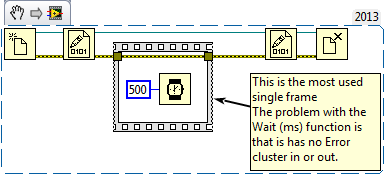

This is a quick example.
To be able to use the power of data flow, we need to use a single frame sequence structure.
As the Wait has no Error cluster in and out, and we want to force the wait between two writes to file, this is one of the options.
An other option would be to put the Wait(ms) function in a sub-vi with Error cluster going in and out of the sub-vi.

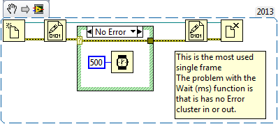

But a more correct way could be:
This will prevent a long wait if there was an error before.
But it all depends on what you want to do.
Message 17 of 26
