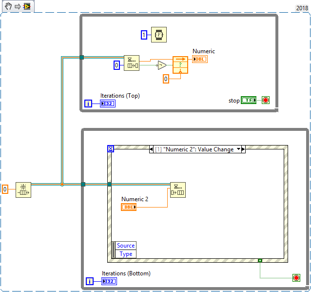

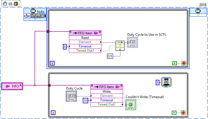

Would something like a VI-Defined FIFO help you?
I didn't compile this, but it generates the intermediate files fine. Obviously if I put the wait in the SCTL as well it fails (I use this just to demonstrate splitting allowed and non-allowed functionality)
Edit: I'm looking at this now - of course, that should be "Not Timeout" as the enable input to the FB node. (And I didn't test that, so just check it's not logically broken to do that to only get valid values - you can check the FB behaviour on Desktop).
Message 6 of 8

I think this is equivalent as a desktop test:
(If you don't want to drag and test, it works 🙂 )
