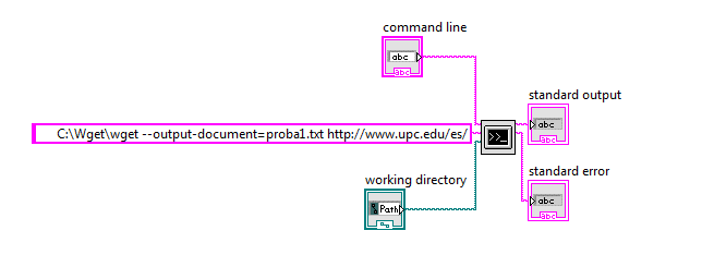

I am execting a VI wich consists on download de font code of an specific web.
the following image works perfectly. as you see, the input string is an standard inpunt control.

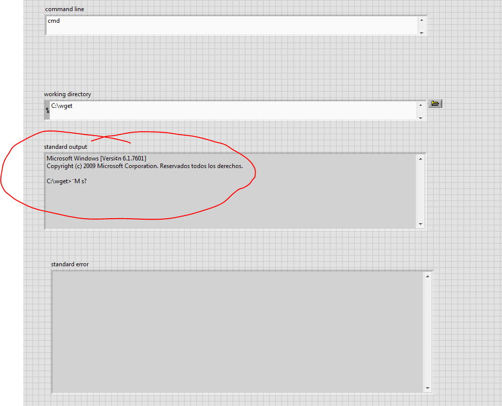

where the front panel is:
I do not want to write the standard input directly, I want to pass it as string, this string will be different depends on the web page that I want to explore.
So the problem is that if I change the standard control input by a constant with the same text, it does not work.
As you can see, the standard input is the same but introduced in differents ways.
The error that appears is the following:
Please, Can you help me?
I attach the VI.
Thanks in advance.

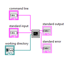

Changing your control's display style to \ Codes, I see that you have "\n\n" at the end, indicating you have a couple of End Of Line characters.  I am pretty sure you do not want those there.  But it is hard to tell without the constant so I can examine it the same way.

So it actually sounds like you have too many "enters" at the end of the command in your control (you had 2 when you should only have 1).
The formatting was purely to help understand exactly what you are sending.  Right-click on the control and choose "Visible Items->Display Style".  You should see a little glyph added to your string control (or constant) to show what the display style is.  When using \ Codes, you will see things like \s for space, \t for a tab, \\ for \, and \n for an end of line ("enter").
