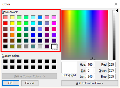

I ran into the same problem and found the solution to be hiding in plain sight.  You need to use a really old word color palette.  One happens to be hiding in current day LabVIEW.  These colors seem to work for me, select colors from the "Basic Colors" section of the "More Colors" dialog in LabVIEW:
