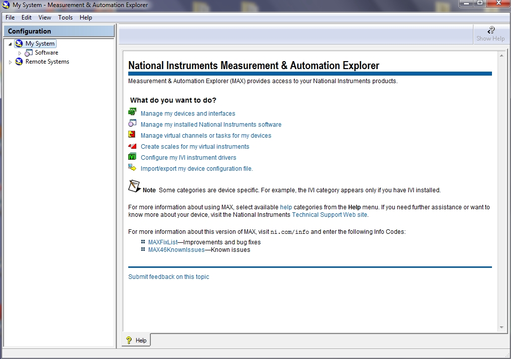

The only thing that would appear in MAX is the com port under Devices and Interfaces>Serial and Parallel. When you use one of the examples (i.e Basic Serial Write and Read), what error code do you get?

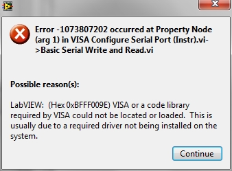

Hi Dennis,
    Thank you for your answer. I am posting three images which I hope could give you useful information. The first corresponds to MAX, no COM port/nothing appears. However as you could see in the next image, in Hardware devices there is a port (COM4) available. The final image corresponds to the error provided by Labview Basic serial Read & Write. The message appears as soon as I run the vi, writing in the I/O control COM4.20897i92955BA2AE7333F220899i0C47BE9A18CE2AE120901i4A36A86F6B840FA3

You say you are using VISA, but have you installed it?  The error dialog you are getting would be typical for someone who hasn't installed the VISA drivers.
I'd recommended popping in the Drivers DVD again and running that.
(5,158 Views)
In fact you were right. I was assuming that VISA was installed, because it was available in the function panel, but it was not installed. It has been quite painfull the installation though. It seems that it did not like the NI Device Drivers DVD in the very begining. After a couple of tries, I have successfully installed NI-VISA. I still do not manage to make the arduino work with the serial instructions, but I could see the TX and RX LEDs in the board blinking so I guess that serial instructions are being sent.
