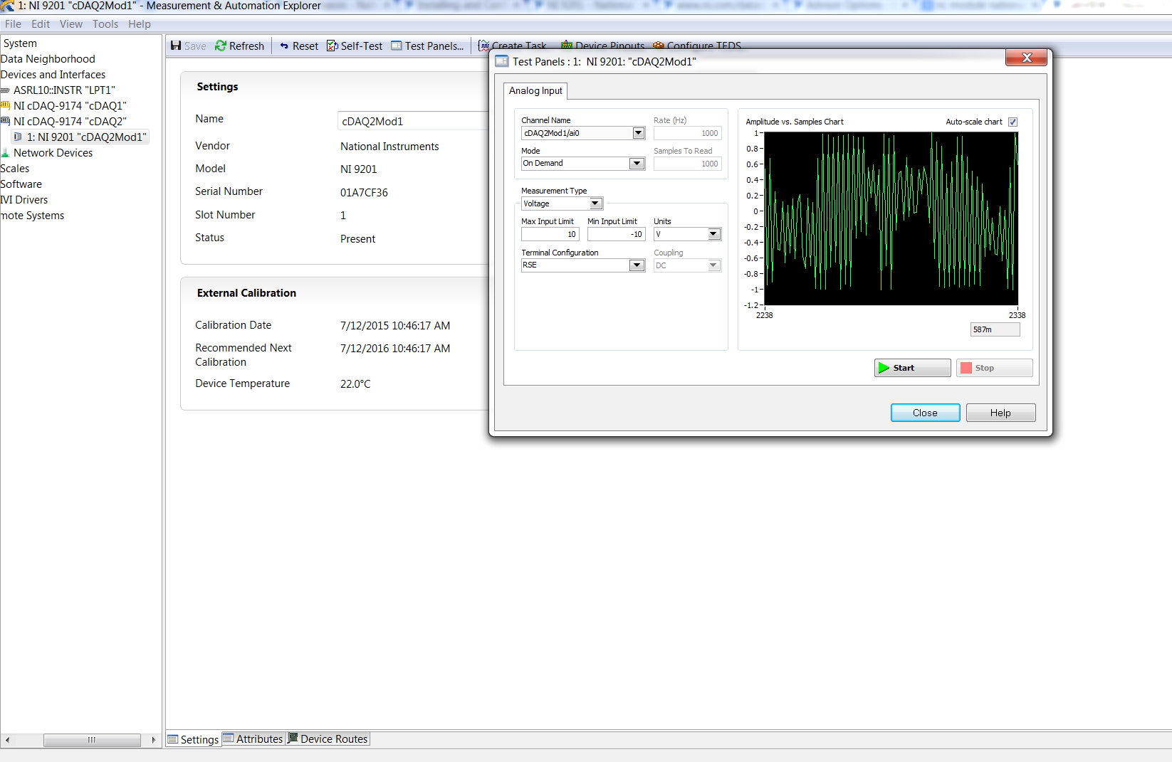

I am trying to connect it to a signal generator and just view the signal in NI MAX on the test panel, but the signal doesn't look right at the moment. The following image shows what I am seeing from what is supposed to be a 10V 100Hz Sine Wave from the sig gen

BNC connector with probe connected to AI0 and ground connected to COM terminal. I have already mentioned what frequency and amplitude I am using and a screenshot of NI MAX  to show my setup. I am not sure what more information I can give.

Hi David,
use a "continuous" sampling mode with your AI instead of "on demand".
Use a sample rate of atleast twice your main signal frequency (as Nyquist says), better use 10times the signal frequency…
