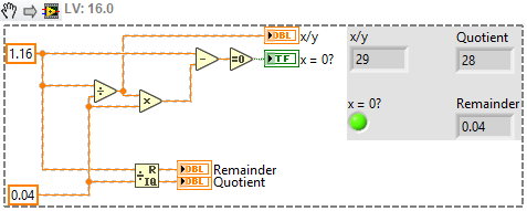

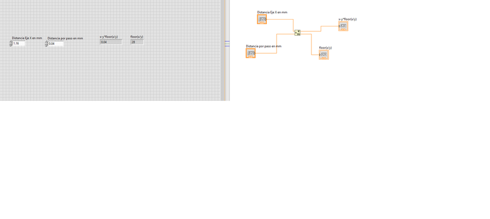

I'm having some issues with the remainder of some operations. For example if i do this operation "1.16/0.04" the remainder in my numeric indicator is 0.04, when must be 0. Because the Quotient of that operation is a whole number as you can see in the image.

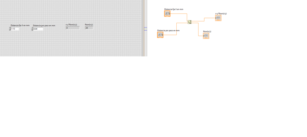

Is there an explication of this? If i do 1.12/0.04 the result is correct. Thank you. There's only issues with some operationsResiduo11010.pngResiduo11010.png

Probably numerical precision and binary representation.

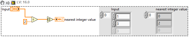

Check this out as a similar phenomenon:
More helpfully, you can consider doing the calculation yourself. I guess that this rounds in a few extra places...
For more discussion of the double datatype (not specific to LabVIEW) you could read my answer here: StackOverflow link. The question has since been marked as a duplicate, so the other question might have more answers too 🙂

Two things wrong here:
1. As cbutcher already stated, Floating Points are not really accurate.  This is a problem with all languages.  The reason being that you cannot put infinite precision in a finite number of bits.  So you will have rounding issues.  The real question is are those errors small enough for you to not care.
2. The Quotient & Remainder is really meant for integers.  When dealing with floating points, a normal division is almost always what is needed.

Hi cbutcher,
That's no "phenomenon", this is how rounding is defined in IEEE754/854!
It's called "bankers rounding", like described here
Message 4 of 9
(5,193 Views)
Perhaps careless wording!
Thanks for the reminder - it's been a little while since I read through any parts of IEEE754 (or even the wikipedia summary!) and I'd forgotten that the recommended default is half-up, half-down.
I suppose that it's typical (at least for non-computing related fields) to round away from zero, so this is my expected behaviour. I was surprised when I saw the "phenomenon" I highlighted, but as you say, I shouldn't have been!
