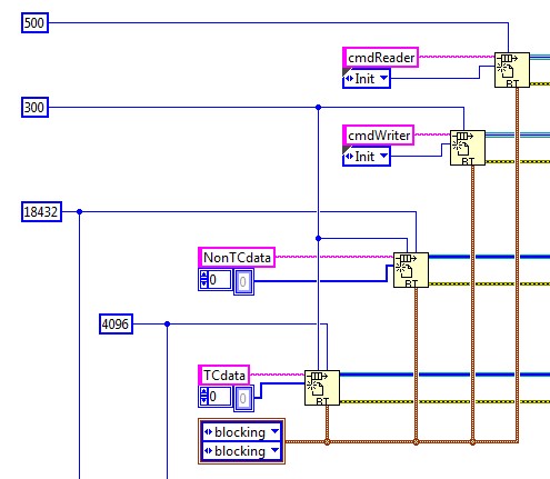

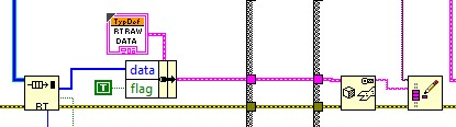

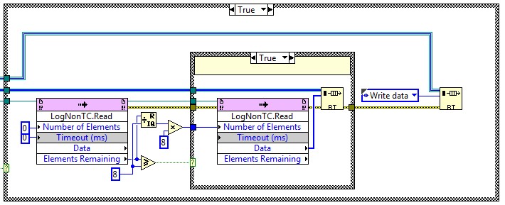

DMA Fifo:
To avoid overflow you have to configure the RT side which has a default size of 10000 (Rio4.0 and above 2^14 elements) or doubled FPGA depth (fifo_config)
RT Fifo:
config example
Read data from DMA to RT Fifo
(read all elements available and write this data block to your RT fifo, which is configured to hold n-Blocks of size x, i.e. 300Blocks of 18432elements each)
--> here I suggest to read a multiple of 8, because of your channel count
Read data from RT fifo to stream
(send data blocks to the host where each block is one element in terms of streaming buffer --> configure streaming buffer)
Configuring large RT Fifo's has an impact on memory usage, so have an eye on it.
Screens are just examples (not functional code)
Hope it helps
Christian
