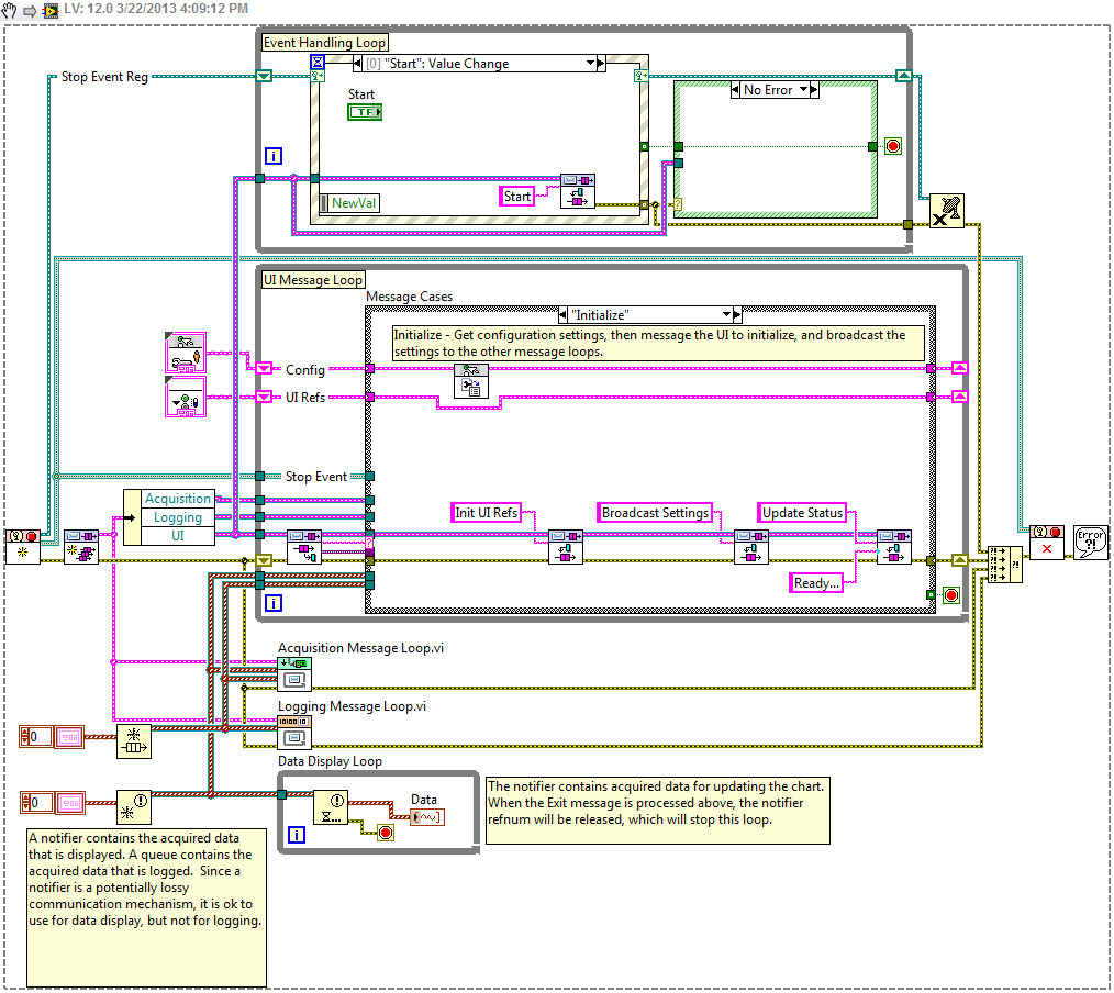

Well without an Event structure you are going to be reduced to polling the GUI.  You should not use your data processing loop to manage the user interaction.  A third loop dedicated to interacting with user input and directing commands to the consumer loop is the better architecture in this case.
LabVIEW 2012 ships with a similar project template (Continuous Measurement and logging) to accomplish a task like you describe.  You would need to replace the event loop with polling on the user controls.  If you can get your hands on a copy of 2012 (Even an eval copy) the help in this sample project would be a great place to learn more about the code than a snippet will show
Message 3 of 10
(3,910 Views)

In few words both of you suggest of using Queued State Machines (Yah, it's really a scaring name XD)
The snapshot seems to confirm that example is some sort of QSM.
