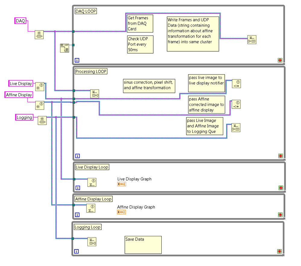

In my LabView programm (please see a very simplified version attached) I am also creating a timestamp after receiving each buffer (live image) which can help me to adress the right transformation matrix (obtained per UDP) to the right live image (acquired with my LabView programm).
In my acquisition loop im using a cluster to drop in the acquired live image including the timestamp (my LabView), as well as the information from the UDP (Transformation matrix + time stamp (from the scanning microscope)). This is actually all working, however I do not have a chance to correct for any mismatch.
It happens often that the acquired live image with labview is shifted by one frame in contrast to the transformation matrix from the laser scanning microscope received per UDP (so the next acquired live image would actually suit the transformation matrix from the iteration before...).
I was thinking that one solution would be to decouple the live and affine loop? In the new created loop I could create a buffer for the transformation matrices including their time stamps, and another buffer with the live images and their corresponding timestamps. After creating 5 or 10 buffers (1 or  2 sec) I could start to rearrange the buffers to sort the correct transformation matrices to the correct live images and then do the calculation?

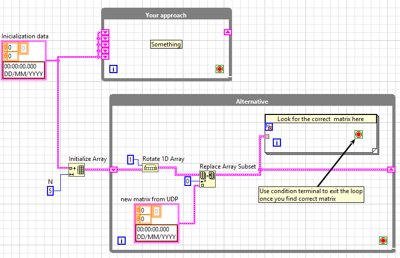

     Increasing the size of a shift register is useful for small buffers (like five elements). You can easily imagine that it starts to be a little messy for higher values. For bigger buffers, it is better to use a shift register with array and store values in it (see picture below). Also, this solution is better if you need to look up specific elements from the buffer (For example if the shift can change during the measurement).
I also add an example of a shift register with an array.

thanks for your reply. I replaced the shift register with arrays and indeed the code looks much cleaner. As a next step I will also implement the for loop (instead of logical comparison (up to 5 Frames now)).
