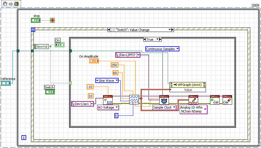

I have a program that I want to use to output an AC voltage where the magnitude can change with the press of a button. I've attached the program. Everything appears to work fine (judging by the graph of the voltage!!) But when I attempt to run this program with the DAQ device (usb-6211), I do not get any voltage output as measured by my voltmeter. It's as if it is not writing the voltage. Am I missing something simple, or will this program not work? Many thanks.

Here is what I am talking about.  However, from what you posted, it looks to me like you are trying to write to a digital line (PFI); you can not do this.  Can you switch the line to an AO and get the response you are looking for?

I would suggest you start by using the internal clock and not stopping and clearing the task immediately after you start it. As Matt mentions, use an event structure and when you stop the VI, stop and clear the task there. As it is now, you can't stop the VI at all except with the teminate button on the toolbar and that's never a good idea.

After sorting through examples and these explanations. I've began to realize that what I want to do is almost as easy as using one of the provided LabVIEW examples. My old program wouldn't write because I never allowed it enough time, before I looped through it again. If I introduced a time delay before clearing the task, I would get a sputtered waveform output. Which won't work, I need a nice smooth output wave.
The example that works great is the "continuous generate waveform voltage with internal clock" which I attached.  The only problem is that I need to be able to change the amplitude of the sine wave while it is running with the click of a button. For example, the program can run continuously with an amplitude of 5. But when I press a button, the sine wave must change to an amplitude of 10 for 0.5 seconds. On a previous post, a user helped me identify a way to do this using shift registers and the "get time" function and then comparing the times in a loop until the difference exceeded my time of 0.5 seconds. But that was with my previous loop program which didn't use the waveform timing and the output sine wave was really choppy.
In this example, I don't see how you can change the amplitude of the sine wave. Is it even possible, or do I have an impossible task??

You are using the wrong example. Look at Cont Gen voltage Wfm-Int Clk-Non Regeneration.
