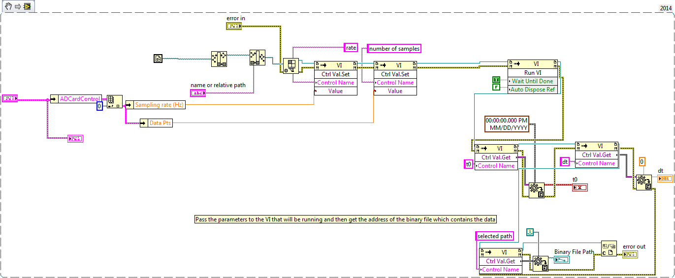

Here is a picture:

That's NOT a snippet! Please read the help on how to create this special type of image.
What happens when you open the VI normally? It seems you are using DAQmx. Is the 64-but version of that installed.

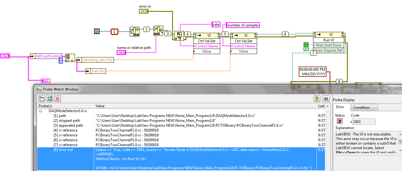

Here is a snippet:
The error is coming from 'Run VI', I have made sure that is the case. Also, the DAQ driver does nto seem to have specific versions for 32 or 64 bit of LabVIEW, and since it is working fine with the 32-bist version, I do not know what is wrong.
I am able to open the VI in question without any problems.

The driver has 32 and 64 bit versions for Windows. Attach the VI you are trying to call.

My apologies.  The error message you posted (if I read it carefully) says the error is coming from PCBinaryTwoChannelF1.  Please attach that VI so we can take a look at it.  Can you try running it in isolation on your 64-bit system (you may need to wire in suitable constants)?  Can it run?

It turn out that the VI had DAQ Assistant express VI, which was, for the 64-bit version of LV, missing. So I reinstalled the DAQmx driver using the latest version available and the problem was solved.
