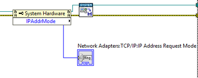

Once you download it, you should be able to change the Property Node values to read. And leave only the IPAddrMode option. Just as shown in the picture below:
After doing so, you'll simply need to input the IP of the device (either your PC or DAQ) you want to know if its DHCP or Static.

First of all thanks for your reply. I did check the community example that you mentioned in the link. The issue is when I get the IPAddressMode from the property node, it gives me the mode for my laptop instead of the cDAQ chassis. That helps me with my PC's IP setting but I still couldn't figure out the IP setting for cDAQ. Is there a glitch or I'm doing something wrong?
