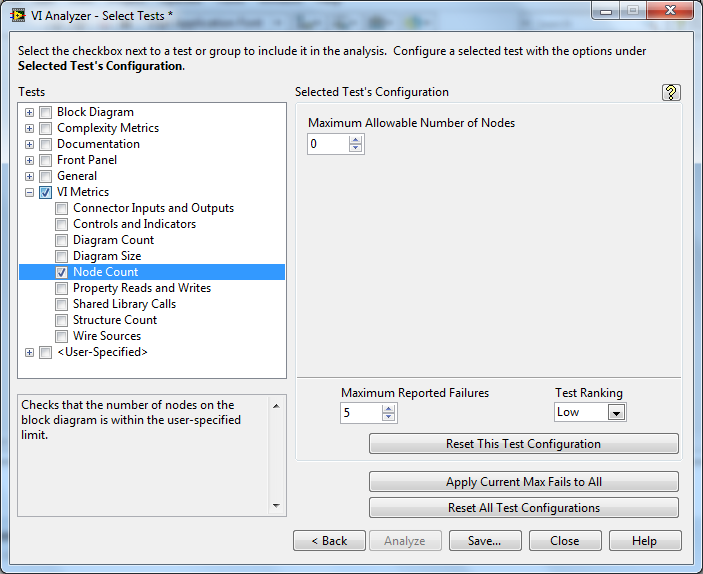

One more alternative...you can use the "Node Count" test in the VI Analyzer Toolkit to return a report of the node count of all your VIs...just change the "Maximum Allowable Number of Nodes" to zero so that every VI tested will return a result:
One benefit of using the VI Analyzer Toolkit is the built-in reporting mechanisms, making it easy to generate a text or HTML file report with all the node count values.
