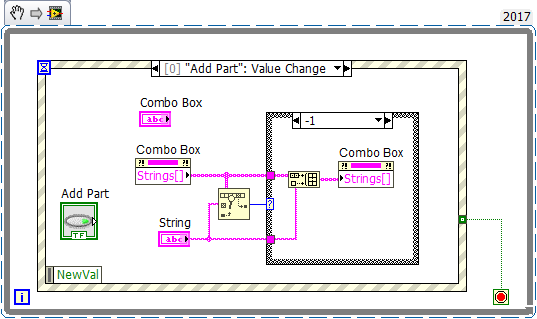

New to LabView and am using 2017 version.  I have a combobox that is already populated with items and a user will be able to add to the combobox items by entering a new string value and pressing a button.  The button is in an event structure which is inside a while loop.  The problem is when the new string value is updated in the combobox there are two.  Is there anything that can be done to prevent the duplicate?

You're using references unnecessarily.  Use property nodes that are linked to the control.
Also, the terminal for the stop button needs to be in it's own Value Change event.

Change the boolean action from "switch until released" to "latch when released"

Works great.  Thanks for your help.
