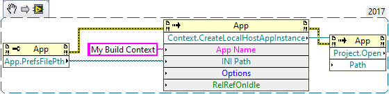

Here's another app builder problem that might bite you. It's been biting me and I just resolved it.
Depending on a number of factors, VIs created by the build that are to be dynamically loaded might be broken when opened by the RTE.  The problem tends to happen when the VIs use certain built-in functions (such as the Error Ring) which are actually XNodes, and when the app that invokes the builder also uses those same XNodes.  Worse yet, the problem is intermittent, you might get a good build, or not. I'm guessing it depends on the order in which things are loaded, which is probably indeterminate.
When you open a project from the GUI, it gets its own application context. But when you open a project programmatically, by default, it's opened in the same context as the VI that opened it. When you open a project programmatically, use a separate context:
Note that when you close the context, everything that's open in that context closes (unless something is holding it open).
Message 12 of 14
