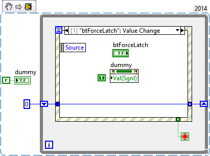

There are many posts in the forum about triggering programmatically a button with latch action and all they point to one solution - using custom user events. For complex projects this is maybe the best solution, but for simple and small projects sometimes it's too sophisticated (creating the event infrastructure requires some time and experience).
Here I'm sharing one another solution to trigger programmatically the buttons with latch actions which is not using events, but in the same time it's fully event driven solution (not using data polling).
The idea is to use "sacrificial" boolean dummy control (like LED), add change value event from this dummy control to the event of the target button and to call somewhere in the code the property node Value(Signal).
The effect is that when pressing the target button (with latch action) or when calling property node Value (Signal) the same event will be triggered.
The dummy control itself could be hidden so it has no impact on front panel. As the solution is event driven it has no impact over the performance of the VI, it has very small additional code and it's simple for understanding.

I, personally, think this is a bad idea.  You are introducing unnecessary complexity to get around additional functionality that NI built into the Boolean Control to give it the useful "Latch When Released" property that makes these buttons ideal for "Push to trigger an Event-driven Action".
When you try to "subvert" this design of a control meant only for User Interaction by asking to "programmatically" push it, you end up having to invent complex schemes such as the one you propose, with "hidden" controls and fancy code that will leave people scratching their heads, even if you do document it carefully in the Block Diagram.
An "easier" way to "Push your Button" and "Program it, Too" is to change the Button's Mechanical Action to Switch when Released.  In the Event Loop for the Value Changed Event for the button, simply drop a Local Variable for the Button and wire "False" to it, effectively resetting it and duplicating the action that LabVIEW does for you if you used the "Latch when Released" Mechanical Action.  You'll find that you can now set a Value (Signaling) Property for this Control.
It is still a Kludge, and should probably be avoided, but it is easier to understand.

Good points! I have to agree that all what you said is correct and this approach with dummy control events have to be avoided.

A version of this is the ONLY way to do this if your event is responding to a button in a different VI.  (In this case you bring out the control ref and create a value property node and set the value to FALSE.)

A better solution is to just change the boolean from latching to switched, then in the Value Change event for it, write  FALSE to a local variable for the boolean.
