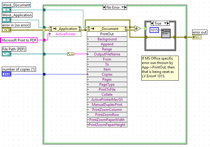

I know this is an old thread, but I've been working on the same thing and got the Microsoft to PDF printer working without a dialog box. Hopefully, this helps someone.
This is an example going from a MS Word document to PDF (but would work for any MS program). This is an edited copy of the Print Report VI that comes with the Report Generation Toolkit. The only edit you need to make is to add an 'Output File Name' to the ActiveX invoke node (and set the printer name to 'Microsoft Print to PDF').
Message 4 of 9

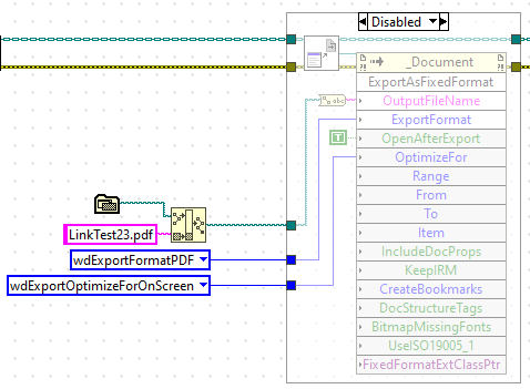

Just a bit further to my previous reply. An easier approach is to use the ActiveX invoke node 'ExportAsFixedFormat'. However, this gives a low-resolution PDF (not one I was happy with) hence why I started looking at the MS Print to PDF printer.

If you specify a different option for "OptimizeFor" then do you get a better quality file? I would imagine that optimizing for screen means any images are only 72dpi.
Message 6 of 9
(10,682 Views)
I tried both optimize for screen and for print, but they both caused images to appear pixelated. The MS Print to PDF Printer is much better.
