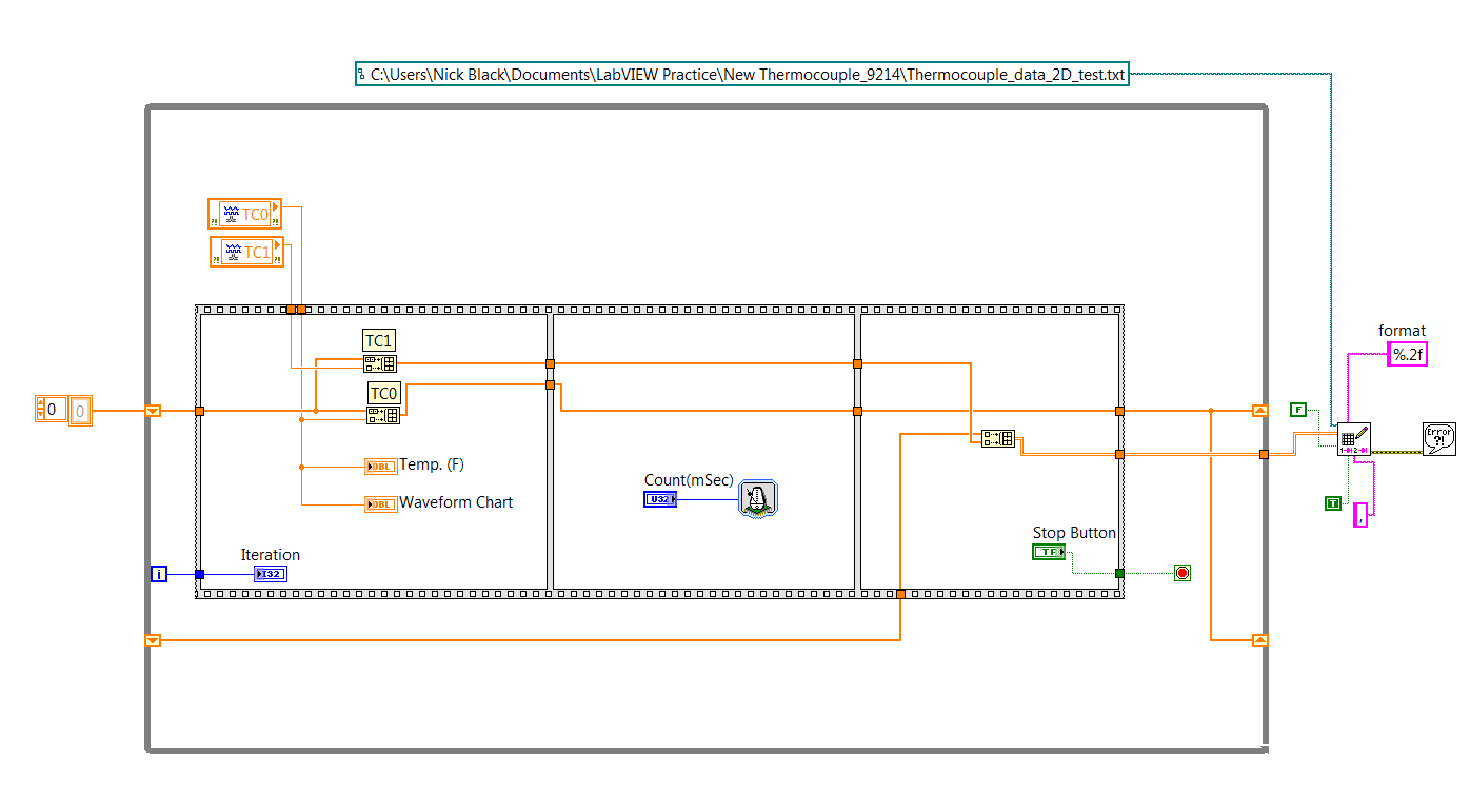

multi channel CSV.PNGWould something like this be the type of management you're talking about? And just add a build array function for each channel I use?
Message 13 of 22
(2,844 Views)
no.
 try to create snippets (menu "Edit"->"Create Snippet") so it is easyier to use.
you've got it quite wrong in fact.
have a look where your data goes.

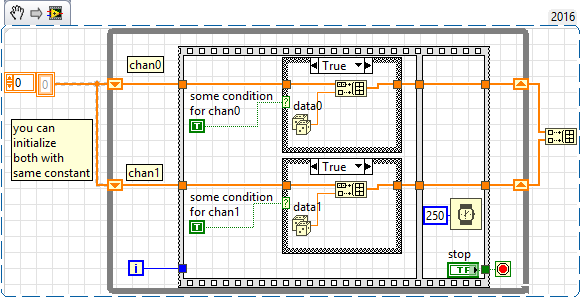

sorry .. the image confused me .. its not sooo wrong 😉
but unfortunate in design. i will make a new snippet

Okay, sorry about that. I wasn't aware of the snippet function before but I'll use that.

the sequence-structure is not mandatory, it is a personal preference to have the WAIT and reading of STOP value at the end.
you could get rid of the first frame, and just by having the wires go through the structure it would be defined to run at the end

Okay, I see now. But what is the purpose of the case structure if there's a true constant wired to it?
Also, I'm using a RT wait until next multiple for controlling my sampling rate. Is that fine to use that? Because I noticed you're using the regular wait function.
Message 18 of 22
(2,805 Views)
i use the standard wait, because unless something is time critical, i think it doesn't matter.
the TRUEs are your condition, if and when to read from the datasource

as exercise:
let your last vi/image and mine run side by side and compare what they do, with highlight execution, retain wire values and probes.
specifically look what data will be at the end of each loop-iteration written to the shift registers.
generally, try to keep your lines straight, group blocks of code that belong together, and keep the code clean in general, it makes debugging and finding logical/data-flow errors much easier to spot
