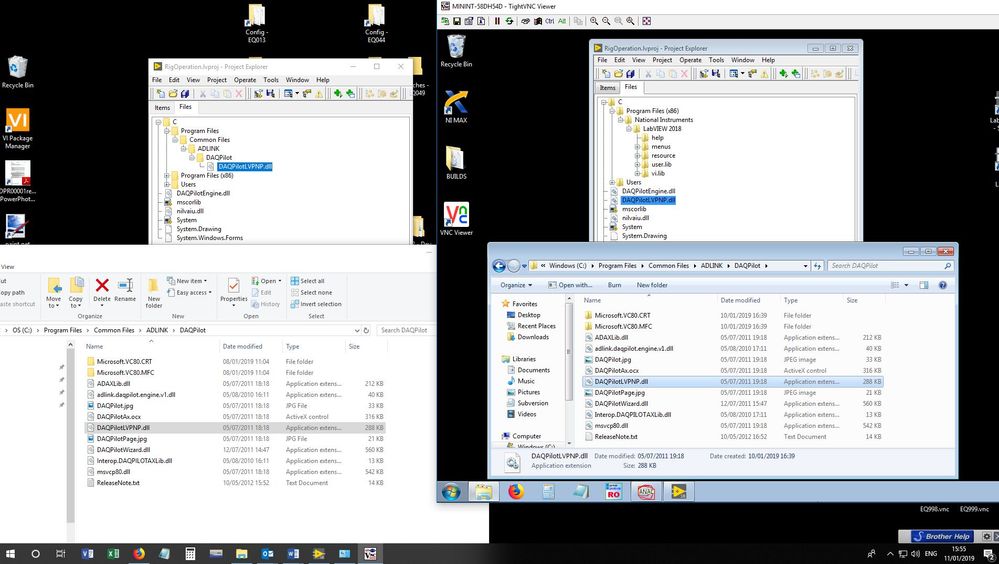

I moved from LabVIEW 2013 LabVIEW 2018 32-bit and I'm now debugging the issues.   The NI part is all working fine.  When I open the Project on the Win10 PC at my desk, around 25% of the ADLINK IO tasks are broken, a double-click on the DAQPilot ADLINK node on the diagram fixes the problem and the VI will run again without errors.  When I take the same project to another PC running Win7, which has the same drivers installed, the same nodes are broken again.  I've been trying to spot the difference for around 8-hours, and the only thing I've noticed is that shown in the attached snips.
It appears the search order on the Win7 PC is slightly different and it thinks the .dll is at the different path.

I actually have 3 different build standards on various PCs, I need the LabVIEW project to correctly link to DAQPilotLVPNP.dll on all 3.
Windows7 32-bit, LabVIEW 2018 32-bit.
Windows7 64-bit, LabVIEW 2018 32-bit.
Windows10 64-bit, LabVIEW 2018 32-bit.
Can anyone explain why the two trees look different:

I've manually checked the location of DAQPilotLVPNP.dll for all PCs, LabVIEW should find it in the same place, and indeed it does with my simple project.
The large Project however, cannot link to DAQPilotLVPNP.dll when I move between PCs.  I've looked at the .lvproj file using a text editor, I just can't find any clues.

Hi Bill, I've read some posts before about people manually editing the .lvproj file to fix linking bugs.  The path in .lvproj stays the same, I'm not editing anything, just trying to run the same project source code on each PC.
<Item Name="DAQPilotLVPNP.dll" Type="Document" URL="DAQPilotLVPNP.dll">
appears at the root of the project in the .lvproj text.
The screen snip above shows the file being found at C:\Program Files\Common Files\ADLINK\DAQPilot on the Win10 PC, but when I move to the Win7 PC, the files view in the Project windows is suggesting the file is at C root, however, there is no copy of DAQPilotLVPNP.dll at C root.
When you create the exe, LabVIEW automatically copies the dll to the data folder that sits with the exe. (DAQPilotLVPNP.dll is not in the always included list in build properties).
The installer of DAQPilot appears to put the components at the expected place on each PC.
