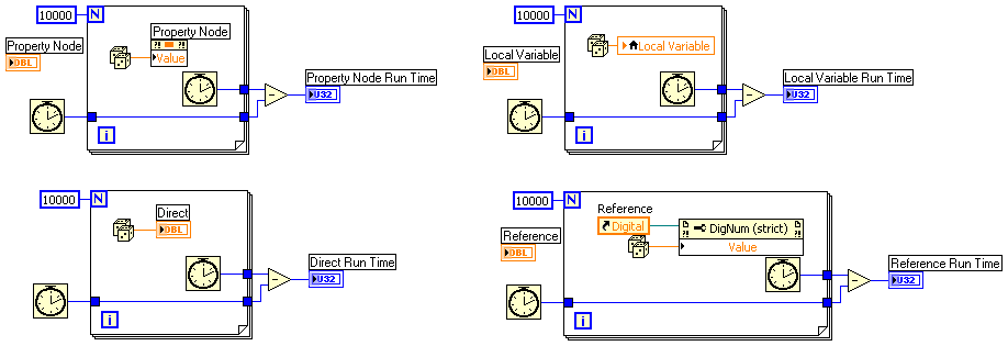

Just to add to what has already been said.  Property nodes are terribly slow.  I once did a benchmark where I simply wrote to an indicator.  I tested this using the terminal, local variable, and a property node.  The local variable was about twice as slow as the terminal.  The property node was thousands of times slower.  I don't have the results with me right now, but it was quite obvious that property nodes are not the way to go.
Just as background, I did that because NI had this major "local variables are evil" campaign and so people started using the property nodes.  The property nodes had the same issues as the locals (race conditions) plus are slower.  I had to perform a crusade against property nodes in my company.  I managed to fix most of the issues by implementing forms of state machines and/or using queues.
If you can, wires are by far the most efficient way to go.  Also stated, shift registers are your friend.  I haven't looked into your code, but I'm guessing a state machine is what you really want.

here are the perfomance timings....that being said, I recommend "The LabVIEW Style Book" by Blume for your diverse architectures and performance matters(ie costant polling inherent in "State Machines" and others).
