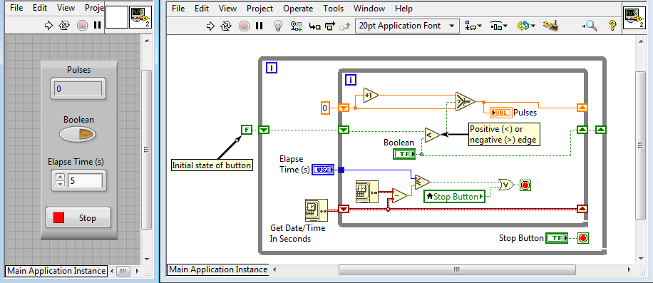

Hey Aaron,
I think you could tackle this by using a rising edge counter, this way you don't need to reset to zero, just ignore the falling edge.
To start again from zero after some time you could use two Get Date/Time In Seconds Functions, get the difference and create a condition with the result.
This may help:
Kudos are welcome 😉
Kudos are welcome 😉 marked solutions are awesome!

Hey Aaron,
The DBL is the pulses indicator, that part of the code just increases +1 each time a rising edge is detected.
I'm not sure I understand the delay part.
Do you want a delay between each 10s sampling cycle? or a delay after a rising edge is detected?
If you want a delay between each sampling cycle, you could implement it like this:
Actually, this is a much better approach that the one showed in my first comment (no nested loops). Smiley Very Happy
If you want the delay after each rising edge, wire the case structure to the boolean comparator output, the one that says "Positive (>)..." instead.
Kudos are welcome 😉
