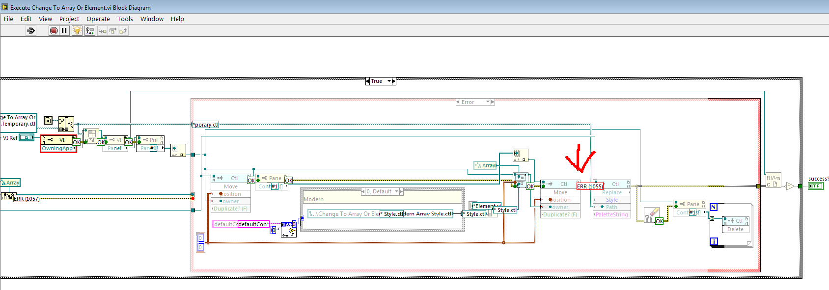

This QD shortcut stopped working in my LV2013 64bit today. I tested in x86-LV2013 - all fine.
I replaced the VIs / the LLB in my QD folder with the ones that are posted here to make sure nothing has gone wrong with my copies on the computer. Still no joy. At least I found the eventual cause: The Move method positioning the newly created array control throws an error 1055, which is an invalid object reference. As the Controls[] property yields a non-empty array (notice the "#1" from highlight mode within the property node) there could actually not be an invalid reference, as the first element is indexed and control references are never closed while LabVIEW is running, even when being told so.
I tried a restart of LabVIEW several times, but to no effect.
Has my Labview installation gone bad?
I appreciate any hints as to what to do.

I don't know what the problem could be. I have the shortcut saved in my [LabVIEW Data]\Quick Drop Plugins folder so that it's accessible in all of my LabVIEW installations. I tried it in several installs (including LabVIEW 2013 64-bit), and it worked fine...it converts a numeric constant to an array of numerics constant, and does the reverse as well.

My problem does not show with constants but with controls only. And only with LV2013 64bit. Even with 64bit it worked well until yesterday.
I just tested constants back and forth and they seem to work fine, also replacing array controls with their scalar counterparts is ok. The behaviour only applies to replacing scalar controls/indicators with an array.
As for your answer - I am forced to conclude that my LabVIEW installation is corrupted somehow. Disturbing though this may be - I doubt I will go through the hassle of repairing or reinstalling my 64bit LabVIEW and possibly having to reinstall all drivers for them to be recognized by the new installation just for one QD shortcut.

Wow, I really have no idea. I got controls and indicators to work fine in LabVIEW 2013 64-bit. Is this reproducible for you just from dropping a numeric control in a blank VI, or can you only reproduce it with a specific control/indicator in a specific VI? And if so, can you post that VI (or a reasonable facsimile) here?
