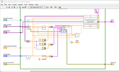

@Sir.K.O. wrote:
Hi There, did anybody find a way how to include qpoases in LabVIEW? Thanks, Sirko
I don't know if there exits a LabView implementation of  qpOASES
But as there is still no example in "C:\Program Files\National Instruments\LabVIEW 20xx\examples\Mathematics\Optimization" for the Quadratic Programming.vi
- someone might find this helpful:
In the Machine Learning Toolkit, the Qudaratic Programming.vi (Interior Points) is used to train a Support Vector Machine -
more important, the toolkit does include a demo which shows how to use it:
