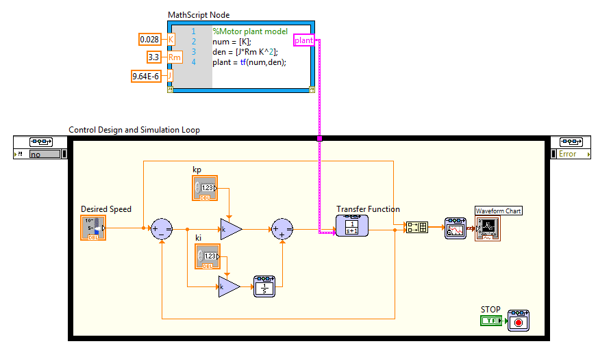

i want only simulation part, i think its regardless of the motor type?
 this only , am i right?

Yes. That's a good standard VI to simulate a direct-drive DC motor with no gearbox. The "K" in this case is the back-emf parameter (i.e, km) and "J" is the equivalent moment of inertia.
P(s) = km / (Rm*J*s+km^2)

The VI you posted above is fine for doing classic DC motor position control using a PD controller. I'm assuming this is from the tutorial:
http://www.ni.com/tutorial/12944/en/
This was developed by NI. If you wish to run this particular VI then you should contact them directly. Take a look at some of the "Simulation" examples given in NI Example Finder (you can access this by going to Help | Examples in LabVIEW).
