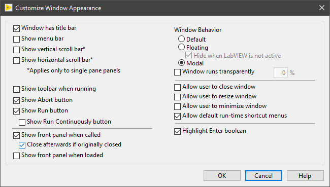

A way to avoid the change to run mode is by calling the VI dynamically:
Right click all calls to the VI
Select Call Setup...
Change to "Reload on each call" or "Load an retain on first call".
The VI will look like this:
You probably want to add the VI in a disabled case, because find all instances won't find the dynamic call.

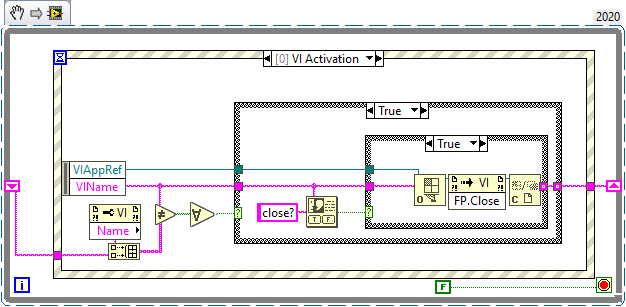

Here's a quick VI that (if running) asks to close a window when activated.
It will close any VI (running or not), probably including clones.
It won't stop VIs, but, if it's the last instance might remove the VI from memory. LV will ask to save the VI.
If you get a modal VI block, open the VI from Windows explorer, it will run (Run When Opened should be true). When re-activating the blocking VI you should be ask to close it.
