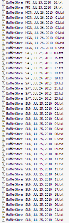

I left the VI runs on CompactRio for the whole weekend. The result I got is shown in the picture below:
20433iEA2ED246D762608B
24 files should be created in one day. While there were only 3 files created in the firest 24 hours ( from Fri 16:00 - Sat 16:00). And after that it worked very well.
When I checked the first three files (created from Fri 16:00 - Sat 16:00), I found that it didn't sample at 10Hz. It sampled at the frequency of about 20Hz (sometimes 18Hz, sometimes 19Hz).
I am confused by the problem a lot. What may cause it didn't work in the first 24 hours and worked after 24 hours? And How could I fix this problem?

Were you writing these files to a LAN? If so, maintenance on the LAN (typical for weekend) could have presented problems with saving files.
