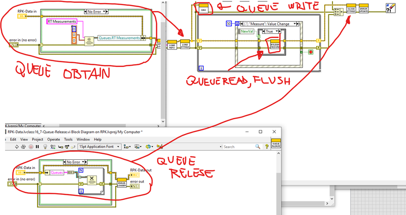

Hello Almog,
My LOOP with (one) Queue:
(I have expected I will have to save more queue data in class, that's why I have "Queues" cluster in class)
But you only need to save Queue reference. Everything else is in VI's.
Upper-left: Writing to queue
Lower-left: Flushing queue
Upper-right: Class
Lower-right: Reading from queue, writing to TDMS.
BR,
Jakob

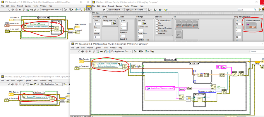

Thanks Jacob,
Where do you obtain the queue in your project?
You then save the Queue reference into the class?
Thanks again,
Almog
Message 3 of 8
(5,890 Views)
Accepted by topic author almog.danzig
Hi Almog,
Yes, Obtaining and Releasing is required (sorry for poor writing):
These is all basic of Queue, implemented into class.
PS: don't get confused with that cluster on Release, like I already mentioned in prev. post, I planned to have more data and more Queues references under Queues section of the class.
Hope that helps.
BR,
Jakob
