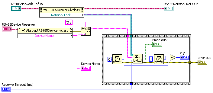

As far as I can tell, this is a bug in LabVIEW. I modified the internal subVI to look like this (and now that I look at it, I see that the Format Into String is redundant):
Basically, it measures how long the enqueue takes to execute. If I set up a long wait on A, then B takes longer to execute than its timeout input (and it doesn't time out, as you pointed out). I'm pretty sure that's never supposed to happen.
I'm not sure what the exact combination required for this is, but I would guess it has to do with the timeout on an enqueue in a reentrant VI. It's relatively rare to put a timeout on an enqueue, so that would explain how such a thing could be missed. Certainly your case is different from common SEQs in that you enqueue to lock, where people usually dequeue.
I would suggest you report this to NI in an orderly fashion and they can investigate it further.
