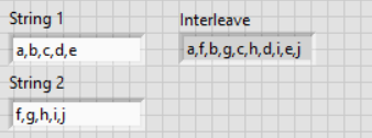

Hmm -- I just realized that you might have meant String1 to be "a,b,c,d,e" and String2 to be "f,g,h,i,j".  Without quotation marks to delimit the String, readers (such as I) might make the wrong assumption.  If this is your intended meaning, then the previous paragraph (describing how to do an Interleave) contains the Solution you need, after you pair it with Spreadsheet String to Array and Array to Spreadsheet String.
Here's the front panel of a VI I just knocked out:
As you can see, it does what you describe, interleaving the elements of the Strings.  The first two functions of this little sub-VI are Spreadsheet String to Array, and the last is Array to Spreadsheet String, with some Array processing (you figure it out) in the middle.
