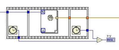

This Quick Drop command will let you time any portion of your VI that you select on the Block Diagram using a three frame stacked sequence structure with tick count (ms) for timing.  If you wanted to time the generation of random numbers, the goal would be what is shown below.
I attached the quick drop plugin to this post.  If you want to try it out for yourself you can download the VI and save it to C:\Program Files (x86)\National Instruments\LabVIEW 2014\resource\dialog\QuickDrop\plugins, the plugin defaults to Ctrl-F.

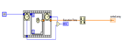

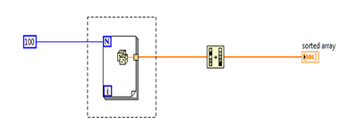

To use this QD command you first select what you want to time the execution rate of.  In this case, we will time a for loop generating 100 random numbers.
Once you have selected what you want to time, simply press Ctrl-Space to bring up the Quick Drop menu and Ctrl-F to drop your timing sequence.
It's definitely not as pretty as what I would like, and if I have time to work on this in the future I would focus on improving the resulting look of the script.  At the very least, I would want to move the timing VIs and subtraction to the bottom of the frame and see if I can implement a Ctrl+Click+Drag of sorts to make sure whatever is created does not overlap what you already have.
