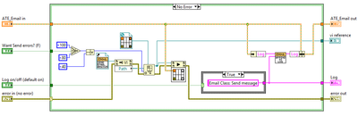

Quick question: if a built executable starts an asynchronous call to a long-ish running VI, then the user fully exits the application right after, does the asynchronously called VI just stop mid-execution? I'll attach a photo, just so the Open VI Ref options can be seen:
