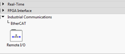

I installed EtherCAT driver, but can't find any palette on the block diagram. Industrial Controls palette only has the CANbus driver.

The palette is belonged to "Industrial Communications".
Remote I/O example here: <National Instruments>\LabVIEW 201*\examples\indcomecat\Remote IO
