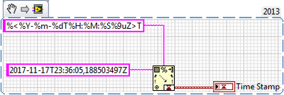

I get from some server time in string type, for examp "2017-11-17T23:36:05.188503497Z". I have found that it is RFC 3339 format. How can I convert it to LabView timestamp type?

But, just be aware of system decimal separator (on my PC dot "." didn't work with the time string, b/c I have comma as separator).
(3,881 Views)
If you prepend the format string with %.; making it:
%.;%<%Y-%m-%dT%H:%M:%S%9uZ>T
then LabVIEW will always expect a decimal point, independent on your configured system locale.
