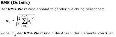

But I think my statement above is wrong. Inside the "NI_MAPro.lvlib:Averaged DC-RMS.vi" for RMS values the VI "RMS.vi" is used. The helpfile tells, the following formula:
Because it uses sampled data it calculates an approximation of RMS which should work for periodic and non periodic signals. Am I rigth?

Hi Michael,
RMS = root mean square - and that's what is calculated according to the formula in your last post.
What's the difference for periodic and non-periodic signals? There is none: you just calculate the RMS of the samples in your array/waveform…
