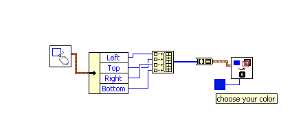

Hi muks,
I've started using that VI - it is more helpful.
However, I now have a new problem - I'd like the ROIs to be colour coded (for example, ROI 1 - Green, ROI 2 - Blue, ROI 3 - Red, ROI 4 - Yellow). How do I go about this?
I've tried using the "IMAQ Overlay ROI" VI, but for some reason it isn't working in the small VI I've built up just to solve these ROIs I'm having. How should I wire it up? Unfourtunately, I can't post my VI on here (security issues).
Thanks for any advice,
David
(5,752 Views)
Use an unbundle by name to the output rectangle of the "imaq select rectangle" vi. Then choose left,top,right,bottom in them and build array and convert array to cluster and feed this to imaq over lay rectangle, In this vi you can choose the overlay color to be displayed.
