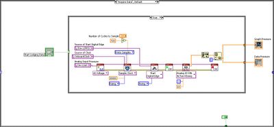

Hi ALL,
My VI didn't stop the acqusition part and always running the program. It suppose to go on the next case structure once the data already acquired. Please see the picture below:
Thanks a lot.
- Fird -
Message 24 of 28
(2,399 Views)
Hi Fird,
      The information that you had posted from previously in the thread is correct.  Are you needing retriggerable aquisition, as was discussed?  Or are you only needing a start trigger?  As for why you're not leaving your case structure- it's hard to tell from the picture you posted, what are your cases?  As well, have you used highlight execution to see where in your program you are getting caught up?
