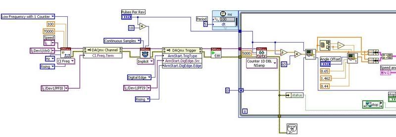

Yes, I noted that as a P.S. in my last picture.  I didn't realize that I hadn't finished it in my picture.
What I want is synch'd individual revolutions of data to be passed to the host computer.  How frequently I get them is somewhat unimportant.  I would like it if I could produce repeatable data (by triggering at the same spot on the encoder each time).

A few comments Re: most recent screenshot:
1.  Re: Start Triggers for counter tasks.
The regular Start Trigger can only be used for counter output (pulse generation) tasks.  For input (measurement) tasks, you would need to use an "Arm Start" trigger.  Trouble is, you can only configure it using the DAQmx Trigger property node, like the ones where you set retriggerable = True.   However, as far as I know, the "Arm Start" trigger (used for counter input tasks) can't be set as retriggerable.  I don't think retriggering a finite acq could easily get you what you want anyway though.  It doesn't leave you enough read time between finishing one acq and getting the next trigger.   In sum, use the DAQmx Trigger property node to configure an "Arm Start" trigger with the appropriate inputs (signal source, active edge, etc.)
2. Since you have a unidirectional motion and you're only performing X1 quadrature decode anyway, I REALLY think you should get rid of the position measurement task entirely.  Use your Freq task alone.  The cumulative index of your freq samples IS the position.  See earlier postings for more details...
3. I always do Period measurement rather than Freq.  They seem conceptually equivalent, but I'm not certain that all the config calls are truly similar.  In any event, you may need to change your DAQmx Timing call to use the "Implicit (Counter)" version rather than the "Sample Clock" version.  I know that's what I'd need to do for a period measurement.
4. Not sure why you'd prefer a finite acq to a continuous acq.  Early in the thread you talked about a graph looking "dumpy."  Was that the main reason?  If so, there are probably other ways to improve it.

Hey guys, I got distracted, but when I came back to this, I finished it up:
It works pretty much as desired.  I still have some buffer issues (but I think a lot of that is related to the fact that I am using an RT system and there is latency going back and forth when it is starting up).  I just wanted to say thank you.
~milq
The final problem that I encountered was the fact that I still had the encoder wired to the block for position.  That of course was not going to give me frequency of the A signal.  Once I got that cleared up, and ironed out the other kinks (in the subVIs you see there) everything is working like a charm.  Thanks again you guys, for your help.

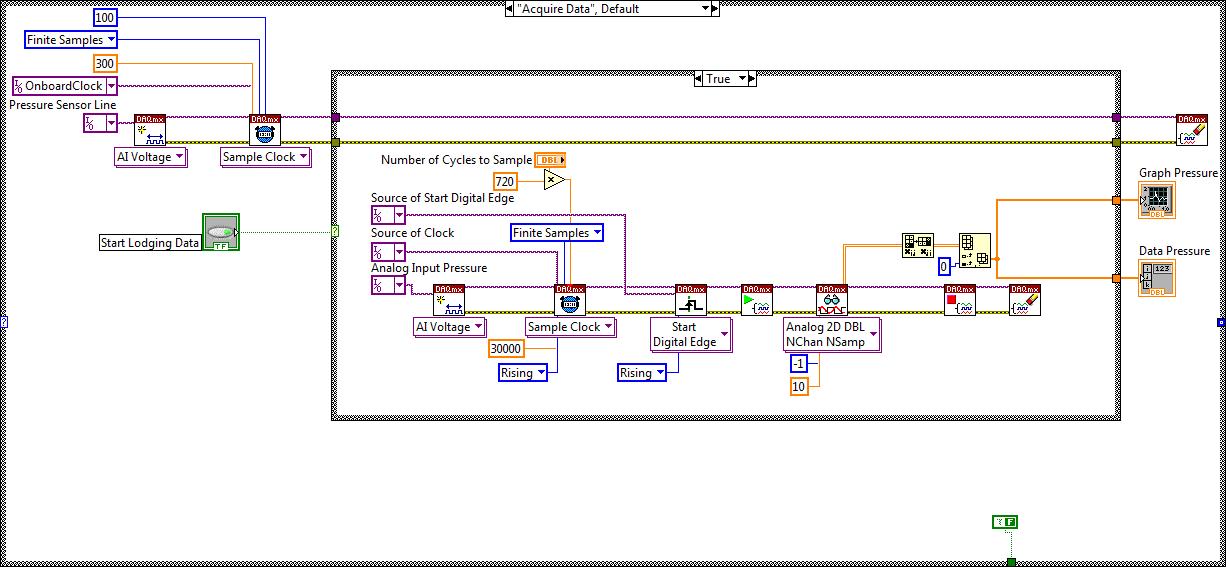

Hi Anita.
Thanks for your response. Basically, I would like to acquire data of pressure using pressure sensor. At first, I would like to use angle encoder to determine the angle of the crank. However, as I'm using USB 6009, I wont be able to do Angular Encoder.
 (Just to let you know, I'm having two USB 6009).
By taking some ideas from the attachment VI, I then design a similar VI to acquire the pressure signal while the angle encoder use as External Clock also as Trigger. Please refer to the picture below.
From an encoder, we will be having 3 main signal from A,B, and Z. For this VI, I'm using A as source of clock while Z as source of a trigger.
I'm not sure whether this way is correct or not.
I will test it tomorrow (as now at France is late night - 3am).
If you have any enquiries that could help me to try out this VI, please let me know.
Thanks.
-Fird-
Message 19 of 28
(3,598 Views)
Hello Fird. I won't help you much with your issue but I will give you little warning. USB 6009 is more a children toy than a serious measurement device for measurements on engines. The card is multiplexed (it has only one A/D). If you are trying to do some fast meausurement and comparison of the pressures you will run into problems since the time when the card is switching to a new channel will play a role. If you have low RPM or lazy pressure changes you should be fine.
